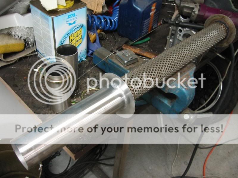

    Like here is some info http://www.daveysprocket.com/projects/smr_exhaust.html
    Here is also some info how to convert that stock silencer to better flowing silencer, dont matter if that is other Husky model exhaust, but that principle is same
    http://www.cafehusky.com/threads/200...ication.16491/
    I would go in my logal hardware store and get like these..
    [IMG][/IMG]
    That pic is for example, i dont know that word in english.
    Lets write this again this here if this help...
    First you have to drill those rivets off, then messure that inner tube length, also diameter, to make that hole tube in those both ends tubes(like that pic under this message, there is that red line, where to messure), so it need to be little smaller than those , then you drive your logal car part seller or hardware store and buy that, it is some exhaust tube where is holes, (cannot remember that name in english), then you can buy spare part that sound dampening stuff, in motorbike, there is that 4-stroke stuff.
    I hope this would help you get make it work
